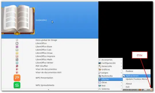

you obtain this:
snapshot ftmenu in Ubuntu 18.04
But the only problem is that some icons are big

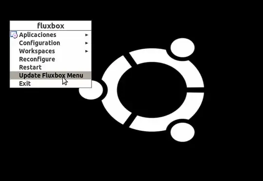

4.- Activate menu, right clic in desktop and clic in "Update Fluxbox Menu"
Activate menu

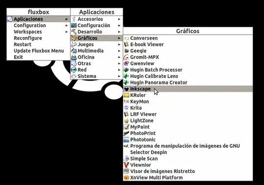

Here an snapshot of all menu apps when you give right clic:
snapshot of menu apps graphics
