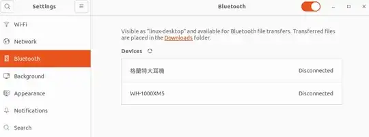

I'm attempting to connect an xbox elite controller over bluetooth to Ubuntu 22.04. The controller works on everything except Ubuntu without issue. Press the pair button, it shows on the list, click it, continue.
On Ubuntu I go to the Bluetooth pairing menu:
and I see nothing. The controller never shows up on the list. Is there a trick to pairing on Ubuntu?

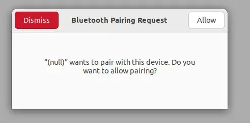

  • I took all the new MAC addresses and dumped them into bulk MAC address identifier and found the one that belonged to Microsoft Corporation
  • From there I did trust <MAC address> followed by connect <MAC address> That got me:
[bluetooth]# connect A8:8C:3E:79:EB:18
Attempting to connect to A8:8C:3E:79:EB:18
[CHG] Device A8:8C:3E:79:EB:18 Connected: yes
Connection successful

  • As soon as I entered the connect command I got the below funky connection window. I hit Allow it all worked after that.
