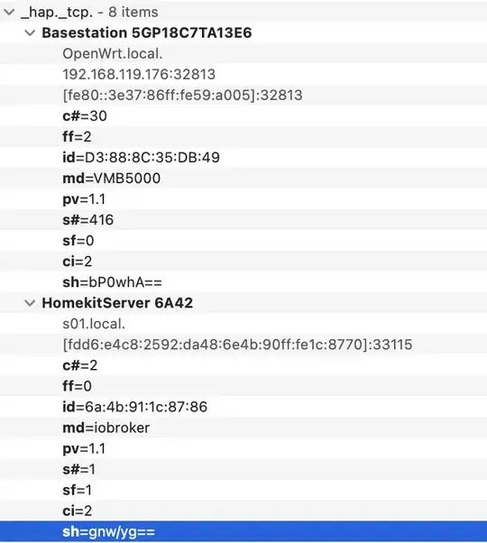

I'm having a weird issue with mDNS running on this host. Using a discover tool on Macos I see the mDNS announcement from this host only on IPv6 and nothing on IPv4. Reason for this troubleshooting was that I can't add "Yahka" a Homkit Bridge emulation anymore into Apple Homekit. I do see the bridge but when adding it times out.

result of the discovery from a different Device (MacOS runing on same network) enter image description here
When trying to add the HomekitServer" to Homekit on ios (smae network) I do see the device as available but when I try to add it, it runs forever trying to add and ends with "not available". Interrestingly enough: During this add process the name changes to "Bridge" in iOS instead of "HomekitServer"
