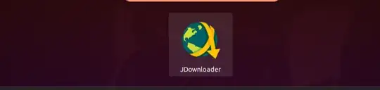

This is the icon that shows when I search Jdownlader on my PC . If I run it it opens Jdownloader2. If I remember correctly this icon showed after I installed Jdownloader from the official website and there was a first icon from the first/terminal install.

jdownloader is packaged as a snap package called jdownloader2 in Ubuntu. Your jdownloader is installed as a snap package, so first uninstall whatever other versions of jdownloader are installed, and then use the snap terminal command to uninstall it as follows:
sudo add-apt-repository --remove ppa:jd-team/jdownloader
sudo apt update
sudo apt remove jdownloader-installer
cd /usr/local/jd2/
sudo ./Uninstall\ JDownloader
sudo snap remove jdownloader2
Note: The installation address of the app might differ based on what you did when installing JDownloader. For finding the address of the installation, you can simply find it in the settings section when you open JDownloader and execute sudo ./Uninstall\ JDownloader in the specified installation directory.
