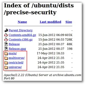

You will get security updates for all your regular repositories, including main, restricted, universe and multiverse, but not for partner.
The top-level structure of the precise-security repository makes this quite clear:
top-level structure of security repo showing partner is not included

The packages in partners are basically proprietary binaries wrapped in a .deb. Incremental "security" updates are not released for these, just regular updates (new versions), which may include security updates. To find out if an update addresses security issues, either look at the provider's page for the update or in the changelog at the launchpad "source" page. The latter is typically easier, e.g. for Adobe Reader (acroread), go to:

The partners repository contains just fifteen packages, and I imagine even regular updates are infrequent (think Adobe Reader). Given the tiny size (5 kb) of the partner update file, I'd just add the actual repository (deb http://archive.canonical.com/ubuntu precise partner) to any "quick check" sources.list file.
Note: While precise-security exists on the partner server, it is (as expected) empty.
