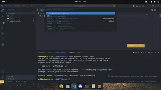

I did not install any Python. The only thing I did was sudo apt install python3-pip and also python3-venv (and python3.11-venv), venvs failed to install but why does VSCode show 4 different Python interpreters now? I didn't install any python version. I installed Ubuntu 20.04 from an ISO file, and upgraded to 23.10. The default Python package on Ubuntu 23.10 is python3.12.
Image of VSCode showing Python interpreters:
Image of VSCode showing interpreters

I used sudo apt install python3-pip it worked and I got pip. Now when I tried sudo apt install python3-venv it generated an error message. I just noticed that the python -m venv command exists.
