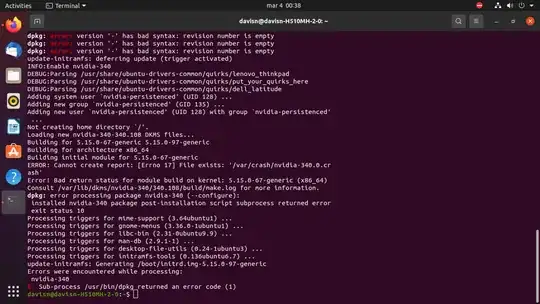

I still need further help for installing the NVIDIA driver properly for my geforce gt 730 gpu on my Ubuntu 20.04 machine, since all methods I tried have failed, I had no luck. It continues to give me this error even reverting to the ga kernel as @DanielT said:enter image description here

This is what flashed on the screen before login when I tried the 470 driver.
Research by @mchid unearthed that the particular version of the card I have, namely PCI Device ID 0x0f02, is known not to work with the 470 driver; other versions may.
I would love to be proven wrong.
Your installation error is because you did not remove the HWE kernel. nvidia-340 will not work with 5.15.0-67-generic. It will only work with 5.4.0-172-generic, as I tested in a 20.04 Docker container. You need to have exactly one kernel installed, and no other kernels for the nvidia-340 driver to work. One line of dpkg: error: version '-' has bad syntax: revision number is empty appears for each kernel version you have, and you have 3, which is 2 more than desired.
Furthermore 5.15.0-67-generic does not even exist in the repositories right now. The closest is 5.15.0-97-generic. Perhaps you forgot to run apt update for a long time, disabled automatic package list fetching, or installed a custom kernel. Anyway, since usual HWE removal steps didn't work for you, let's try something more forceful:
sudo -i
apt update apt purge nvidia-340 dpkg --configure -a apt upgrade apt dist-upgrade
If the next step fails, don't reboot until you do apt install linux-generic
dpkg --get-selections | cut -f1 | grep '^linux-[^:]*[[:digit:]]' | xargs apt purge apt install linux-headers-5.4.0-172 linux-headers-5.4.0-172-generic linux-image-5.4.0-172-generic linux-modules-5.4.0-172-generic linux-modules-extra-5.4.0-172-generic
apt install nvidia-340
