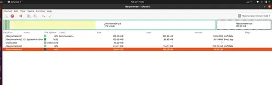

I've had Ubuntu System with the size of 100 GiB. I've made some manipulations for repairing the system and, as a result, my Linux cannot boot, and GParted shows there are only 1 GiB filled on the system. But I know that all 100 Gib are filled. I've tried mkfs and fsck, but it didn't help. Also after mounting Linux command ls /mnt shows only one folder, lost+found, which is empty. I don't have backups (only superblock backups) (I know I'm jerk).
Is there a way to return all 100 GiB of data in Linux?
