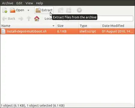

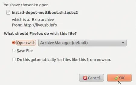

  1. Download and Open the Script with Ubuntu's Archive Manager
    Open

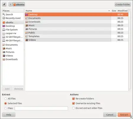

  2. Extract the install-depot-multiboot.sh Script to your Desktop
    Extract
    Desktop

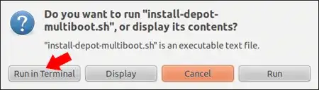

  3. Double Click install-depot-multiboot.sh from your desktop and select the option to Run in Terminal
    Run

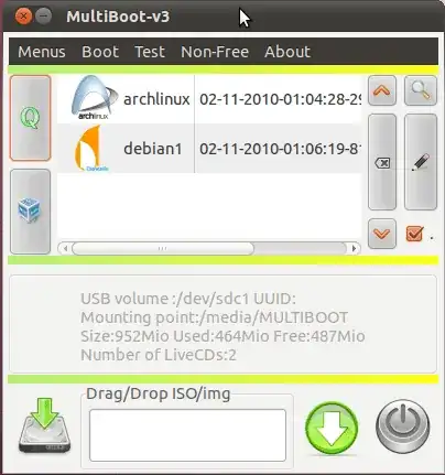

Second, how to use it
  1. Insert a USB Drive
  2. Launch the Script via Applications > Accessories > MultiBoot
  3. Select your USB Device from the list and click Validate
    Validate
  4. Now simply Drag and Drop an ISO into the Window to add the Distribution (repeat the process to add more ISOs)
    ISO
  5. Once finished, restart your PC, set your boot menu to boot from the USB device, Select the Distro you want to Boot and enjoy!
