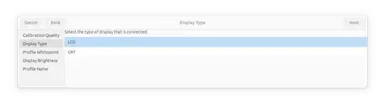

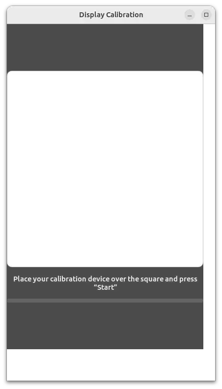

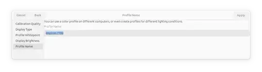

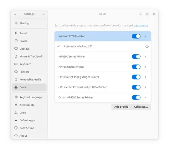

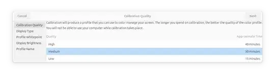

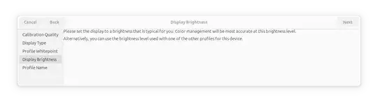

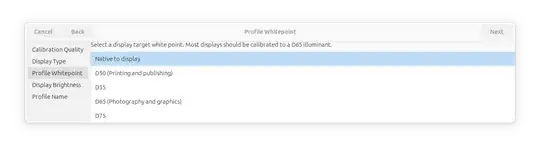

I open Settings and go to the Color section, select my display, and click on the calibrate button. I go through the following steps... enter image description here enter image description here enter image description here enter image description here enter image description here enter image description here
And here's where I get stopped. Where is the Start button?

Update #2 - 2/22/24:
After implementing the patch from the answer by Daniel T (thanks BTW), it does now get a "Start" button, but after clicking it, the color patch remains white, and it errors out with "internal error".
See the following information from the terminal, and syslog.

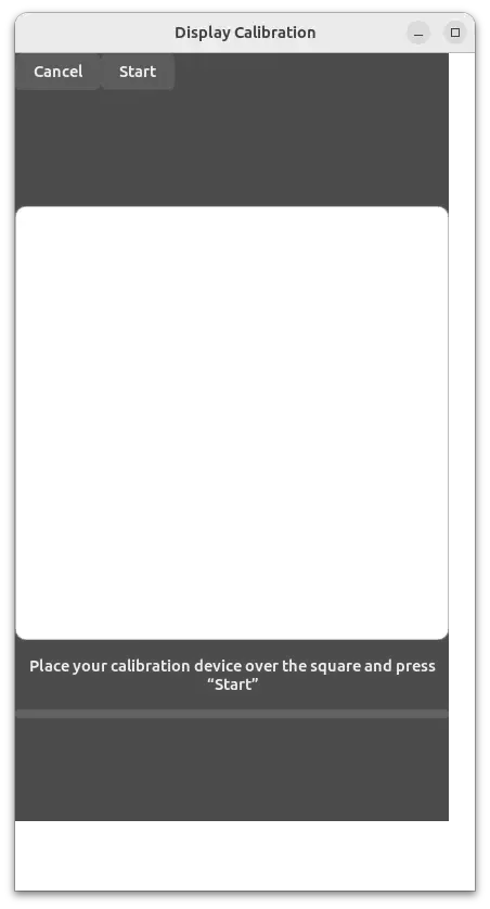

Update #3 - 2/22/24:

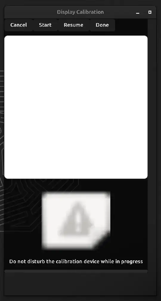

Here's the screenshot that Daniel T's patch created...

It is possible to make the start button show up:
mkdir askubuntu_color_calibration_fix
gresource extract /bin/gnome-control-center /org/gnome/control-center/color/cc-color-calibrate.ui |
    sed 's/ internal-child="action_area"//' > askubuntu_color_calibration_fix/cc-color-calibrate.ui
export G_RESOURCE_OVERLAYS="/org/gnome/control-center/color=$(realpath askubuntu_color_calibration_fix)"
# export GTK_DEBUG=interactive
When the Settings app is launched this way, it should show the Start button. For me, GNOME doesn't let me click Calibrate without a colorimeter leaving me to use GtkInspector and set the window to visible, which may look different from a normal system:
gtk inspector display calibration
The problem is caused by the port to GTK4 being untested. The row that holds the button is supposed to be there, but GTK4 doesn't understand the unnecessary internal-child attribute. The action_area value doesn't seem to be used by the code. I just patched it out and injected it with a GResource overlay.
