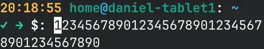

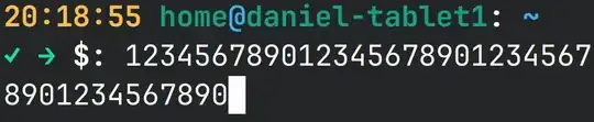

  • Prompt demo:
    prompt demo
  • Long string:
    long string
  • Long string then Ctrl+:
    long string then ←

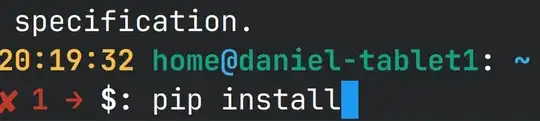

  • pip install then echo:

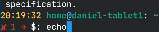

  • echo then in history:
    echo then ↑ in history
