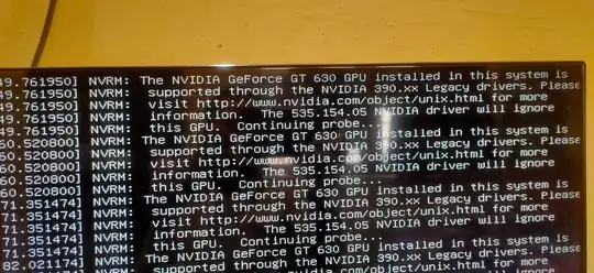

i have installed graphic drivers 535, but it says 390 version is supported. After installing 390 version drivers my pc doesn't boot properly.
this is the error an getting

The definite answer seems to be that the legacy release 390 series of drivers is out of support...
This has been my question regarding this problem. So every graphics card that is is only supported by the NVidia 390 series driver does not work anymore with kernel 6.2.0 and above.
I use the Nouveau driver - which somewhat works.
