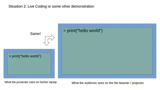

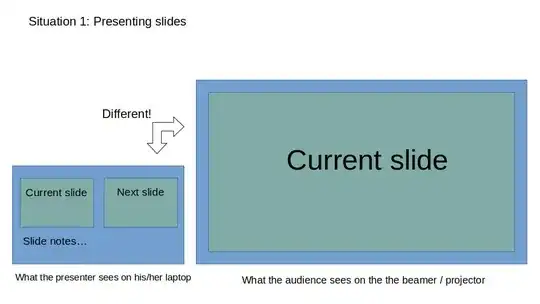

When connecting an external monitor / beamer / projector to my laptop, I can choose between two modes: Join Displays and Mirror (see here). When teaching, I need a combination of the two modes: I would like to use the join displays setup, but mirror one application (even better: one workspace).
Ideally, the students would see my mouse as well, just as they would if I would use the mirror-mode. (Edit:) I want to switch between the following two situations seamlessly:

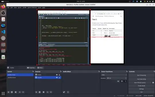

OBS Studio can solve this problem nicely.

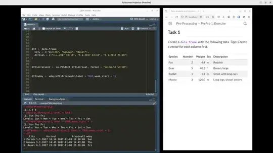

Once installed, you can add your application as a Source via Window Capture PipeWire or XComposite. You then choose Full Screen Projector (Preview) and select the external screen / projector / beamer.
OBS does not support sharing a specific workspace (see here). But you can create your own arrangement of applications that you want to share, either by
  1. arranging them in a single scene (e.g. side by side) or
  2. by distributing them over several scenes, which layers them on top of each other. Two switch between applications, you simply need to click on the respective scene, which brings the application(s) in this scene to up to the top.
Of course, 1 and 2 can be combined. This requires some initial setup, but is very much what I was looking for.

OBS on my internal monitor:
The OBS preview on my external monitor / beamer / projector
