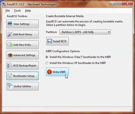

Go to the "BCD Deployment" menu in EasyBCD. Then click the "Write MBR" button.
Reboot, and you're all set!

Both answers were great so I upvoted them. In the end, I found it easier than I might have imagined.
Since I had used EasyBCD on Windows to set up the Windows boot manager, I opened it and found an option to repair the MBR. I ran it - somewhat nervously - rebooted, and it was all back to normal! Nice program!
