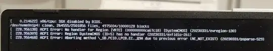

As the title says, I can't enter to Ubuntu. It gets stuck after grub bootloader.
After some minutes the following message appears related with APCI:
APCI error
In order to try to solve it, I have check some of the options of the recovery mode from the kernel and realise dpkg shows error:
dpkg error from recovery mode
If there is no way to solve it, irremediably I guess I will have to reinstall Ubuntu. But I want to avoid it.
Thanks in advance!
Solved! I have reinstalled Ubuntu desktop and everything come back. Thanks!
'sudo apt install --reinstall ubuntu-desktop'
