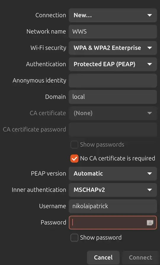

I need to connect to a WiFi network that has WPA3-Enterprise as its security method for Wifi with username/password authentication. In windows, I can connect to this network just fine, by only having to enter the username and password given to me for the network, with no pre-shared key or certificate so I assume EAP is being used.
However, when I try to connect to the network in Ubuntu 23.10 using the GNOME GUI, I see that no WPA3-Enteprise option is available from the drop-down of security methods, only WPA3-personal: enter image description here
I also tried the solution specified in in this answer with NetworkManager but to no success.
I also tried the following netplan configuration:
network:
  version: 2
  renderer: NetworkManager
  wifis:
    wlpXXX:
      dhcp4: true
      access-points:
        "WWS":
          networkmanager:
            passthrough:
              wifi-security.key-mgmt: "wpa-eap"
              wifi-sec.eap: "peap"
              wifi-sec.identity: "my-username-here"
              wifi-sec.password: "my-password-here"
              wifi-sec.phase2-auth: "mschapv2"
But I still can't get it to connect.
So how can I connect to WPA3-enteprise in Ubuntu 23.10 , and is it even currently supported?
Edit: When I try to connect in GNOME through WPA/WPA2 PEAP, a lightbox dialogue opens asking for my username and password. After I enter it, the network still remains unconnected and I am asked for my username password a second time after about 30 seconds. Nothing happens after entering it a second time. Output of NetworkManager while trying to connect is as follows:

Artichoke
  • 173
Let's fix the problems in the configuration. Your final setup might look like this:
example WPA2
Domain
This is weird. I have my username as "flastname123@uottawa.ca", and the part after the "@" is the domain. Since you don't have a "@", we will have to guess. Try the following in succession:
  • local
  • WWS
  • WWS-DC01-CA
  • WWS.DC01.CA
  • DC01-CA
  • DC01.CA
  • WORKGROUP
  • If none of these work dump the certificate. Look for the CN = subdomain.domain.tld and use that or shorten that to domain.tld .
  • Then repeat for any that exist under "X509v3 Subject Alternative Name"
Anonymous identity
I've never used this. Online sources say that some networks need a different email-address-like username for this. You can try both leaving it blank or using what you originally put.
CA certificate
We will just use "No CA certificate is required" for now because we are debugging. Once you get it working, you can add the dumped certificate. If it doesn't work, you might need to use the CA that issued it (i.e. its parent).
Daniel T
  • 5,339
