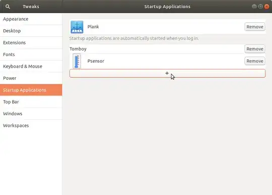

  13. Configure the Plank application to start automatically after reboot.
    Add Plank to Startup Applications
