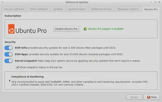

Other Things I Tried I attempted to turn off the "Kernel LivePatch" so I could try to turn it on again to see if that would fix it but I got an error (shown in image) there too.
LivePatch settings
Right after I disabled LivePatch I tried to enable it again and that caused an error too, so it's in an unknown state:
LivePatch unknown state
