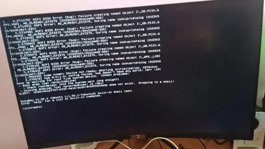

The problem is, most of the time when i try to boot Ubuntu, i get the nvme device not ready, aborting installation error. And then it drops to BusyBox/initramfs. Sometimes when i wait about 20 seconds in the GRUB boot screen, Ubuntu opens up, sometimes (and most times) it doesn't.
Here's the picture of the error; picture of the error
