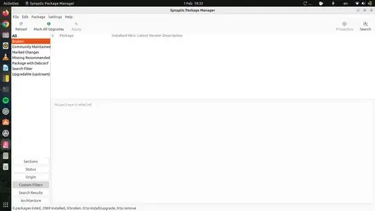

The following packages have unmet dependencies: winehq-stable : Dependencies: wine-stable (= 9.0.0.0.0~jammy-1) E: Unable to fix errors: you have broken packages committed.
sudo dpkg -l | grep '^.[^i]' command output:

Alternative 02:
Install synaptic package manager with:
sudo apt install synaptic
Launch Synaptic Package Manager and go to Custom Filters -> Broken, a list of broken packages will be listed. You need to select them in the checkbox and mark them for removal. And apply the changes. The GUI application will handle the broken packages for you.
synaptic
