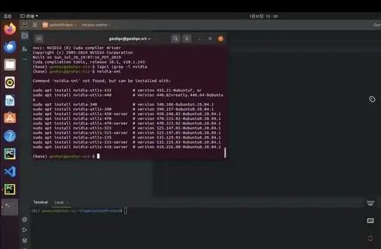

I want to install CUDA, so I need to check the driver and CUDA version, but when I input nvidia-smi I get the following error: Command "nvidia-smi" not found, but can be installed with: My graphics card should be a MTT S80.

I would suspect based on the hardware you've stated that none of the NVIDIA drivers will help you, because the MTT S80 is not an NVIDIA graphics card.
A quick cursory google search shows that the MTT S80 is a Chinese brand graphics card that does not use an NVIDIA chipset, nor an AMD chipset. It's actually a PowerVR based card, and from various sources I could tell online, the MTT S80's actual software/drivers support just is not there for any use.
Also, given that it is not an NVIDIA card, you won't get nvidia-smi ever detecting the card. This is supported by the fact you ran lspci | grep -i nvidia and got nothing back. Therefore, I don't believe you will be able to use the NVIDIA CUDA toolkit with an MTT S80.
