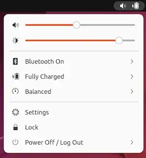

But when I rebooted after installation WiFi does not work

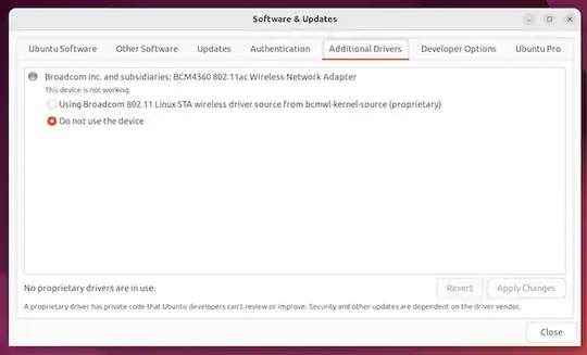

hmm, driver is not active then activating and applying changes as I did before install but:
What? It was work before I rebooted after install

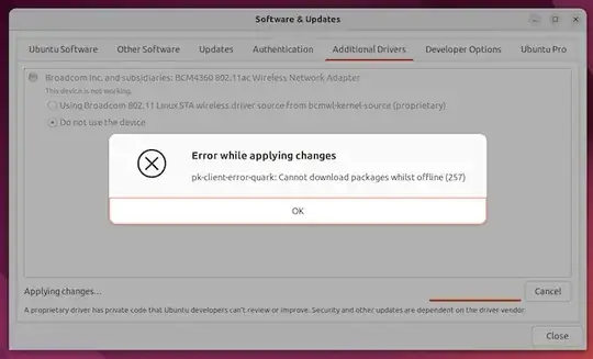

How to install working driver from LiveCD?
There is no internet now. LiveCD is only one source?

I have read a lot of solutions and all of them recommends to install something without working WiFi adapter, without internet.
But I found a solution that is suitable for me:
To use cellular internet via usb cable. Both iOS and Android gave me network to download driver.
