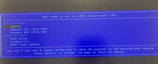

    • Pressing F2 got me into Boot Options (which listed ubuntu, Onboard NIC (IPV4/6 PXE) under "UEFI Options", and BIOS Setup, Diagnostics, and BIOS Flash Update under "OTHER OPTIONS"). enter image description here
    • Pressing F12 got me into BiOS.
      • The boot order in BiOS seems to be correct; the first priority is called ubuntu. Secure Boot is disabled as well.
