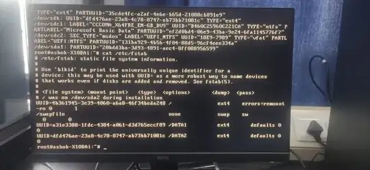

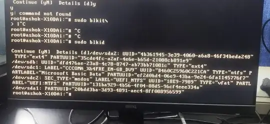

Even rebooting the system into Advanced Options and selecting one of the recovery options, didn't give us the desired result i.e. a normal boot. We searched on the forum and fount this and we also think that we have fstab related problem. Here are the screenshots of the output that we get for sudo blkid and cat /etc/fstab/:
output of sudo blkid output of cat /etc/fstab/
Can anybody please point out what the problem is with our system?

I am not an expert on options used in fstab, I also have to touch this file on very rare occassions, so the following is just an idea.
In /etc/fstab there is a disk listed with an UUID starting with "a31e3388", also signified by its mount point: /DATA1.
In the output of blkid I don't see that UUID, so I would assume that may be the disk that you had removed.
Accordingly, in the most primitive fashion, I would try to "comment out" (to deactivate) the corresponding line in fstab, by prepending a # character at the start of that line.
Perhaps make a backup copy of /etc/fstab before editing it.
Editing can be done e.g. with the "nano" text editor, the command will look:
nano /etc/fstab
Apparently you won't need sudo, as you already appear to be on the root prompt.
As "nano" — even while perhaps the easiest choice for the task — is not an entirely straightforward text editor, so maybe look into some short introductory video on the essentials of its usage before you attempt to use it.
Afer a successful edit, I would attempt to run the command:
reboot now
