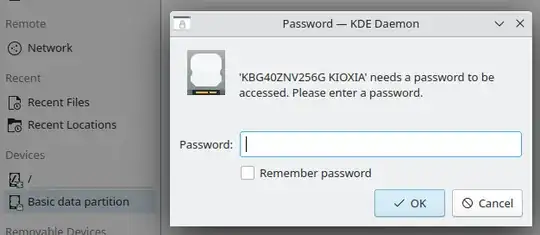

Kubuntu cant access Windows 11 NVMe drive even when secure boot and fast boot disabled in bios and also in windows 11 disabled fast boot, Bitlocker wasnt ON
See screenshot
After in Bios disabling secure boot then disk in windows got new icon

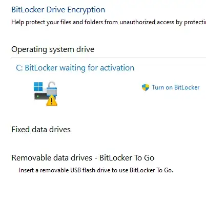

In Windows settings showing bitlocker hasnt finished setting up, but in middle. Now it should be off. enter image description here
Kangarooo
  • 5,223
In control panel Bitlocker shows its off. enter image description here

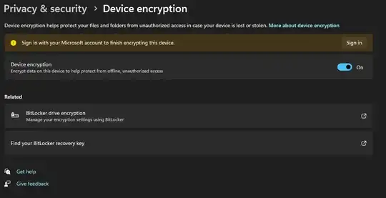

in windows settings Privacy & Security category Device encryption showing bitlocker is on.
In setting page was able to turn off and then it was not semi-on anymore, just few minutes decrypting and installing Kubuntu
