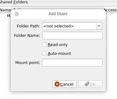

When you set up Virtual Box to share the folder you see a pop up box like this:
It is the Folder Name in the above picture.
