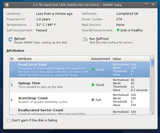

You'll see this message when a hard disk's S.M.A.R.T. (Self-Monitoring, Analysis, and Reporting Technology) status begins to report a failure.
Modern disks have a set of tests and benchmarks as part of their S.M.A.R.T. profile and operating systems perform quick tests on them occasionally. When certain tests fall below their specified operating values, this is usually a sign that the disk is getting old and that its performance will likely quickly continue to deteriorate to the point where you suffer data loss or it just packs up and dies.
You can verify this through Disk Utility (sitting in System -> Administration). Find the disk, click SMART Data and you'll see a list of tests. Not all tests are performed automatically so you can manually set it to run a full test cycle but as soon as you see bad sectors or tests that are failing really poorly, the disk is as good as dead.
Disk utility example
