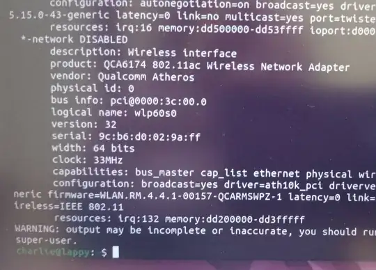

Adapter list:
Adapter list

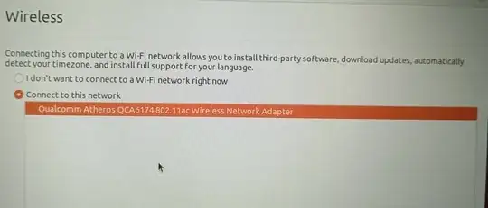

Install list:
Install list

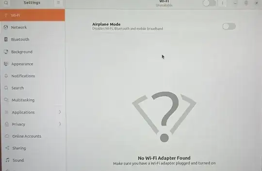

Wi-Fi settings:
Wi-Fi settings
