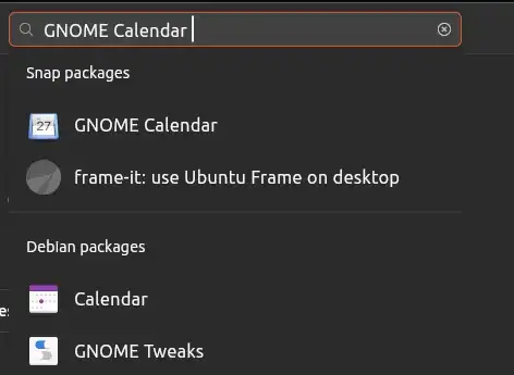

Edit: after @steeldriver comment, I checked, and the calendar was installed via the 'App Center'. Now I reinstalled it from the 'Software' application (still DEB, not flatpak, not snap) - and it works perfectly.
But as far as I know the App Center should be the new way for installing apps. So I am not sure whether this needs further reporting or something just went off in my local system. (I also noticed that the app icon it not working well in the App Center way, while having no issues in the Software way. )
Edit2: well, my eyes need further training, it was a snap installation, and the deb package fixed the issue.
