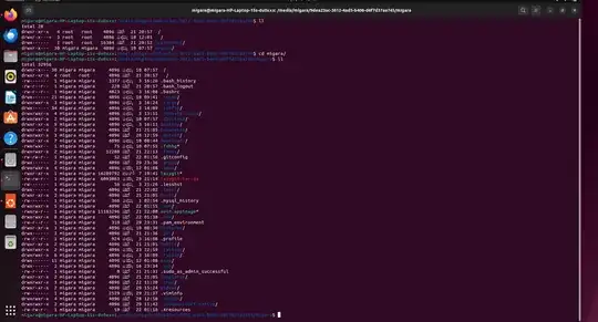

I have previously installed Ubuntu /home in HDD, but in new installation there is a new home directory. How to change it to the previous /home directory. in HDD? Could I replace new home with my old home, or do I need to reinstall Ubuntu 22.04?
Previously installed /home directory:
previously installed /home directory

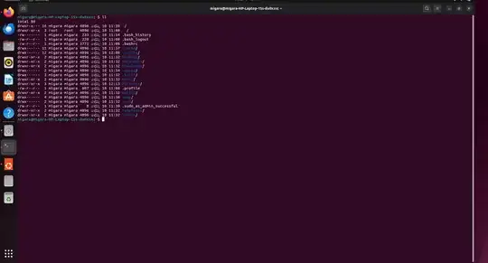

Newly installed /home directory:
newly installed /home directory

A user's HOME directory is specified in /etc/passwd and can be changed there.
Read man 5 passwd;man sudoedit
Once you've changed it, logoff and login to make ot take effect.
