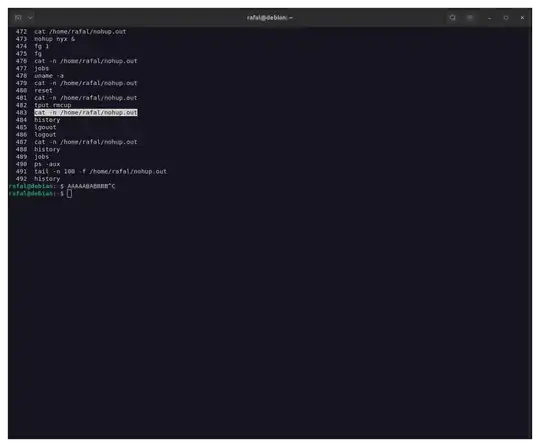

  1. Shift+PgUp writes 2~ on the command line instead of scrolling,
  2. Ctrl+Shift+ writes A on the command line instead of scrolling,
  3. Terminal on my home laptop shows only 24 rows, no matter what command I'll throw at it: history shows only 24 rows; cat -n /home/rafal/nohup.outor another command with a long output, px -aux shows only 24 rows;
  1. The scrollbar on the right fills the entire vertical height of the window, indicating that there's nothing to scroll back to, while there are actually hundreds of lines above;
  2. Turning the mouse wheel cycles the current line through my command history (same as UP key) instead of scrolling.
  3. Of course I have 10 000 lines set in my gnome_terminal settings.

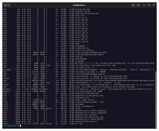

In order to reinitialize the terminal, I've used reset to fix this. And it did fix terminal. Now after I use px -aux command I get full window height of lines like so:

This is an addition to @terdon's answer, not a replacement for that.
Most terminal emulators have a "normal screen" and an "alternate screen". The latter one doesn't have a scrollback buffer, and is typically used by fullscreen apps. Apparently nyx is also such an application that switches to the alternate screen, that's why you cannot scroll.
Several terminals, including GNOME Terminal that you're using, send the keycodes of Shift+PageUp and friends (the scrolling keycombos) to the running application if you're on the alternate screen.
