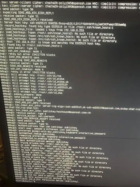

  • ssh -vvvv ubuntu@192.168.8.253 > diagnostic.txt fails to pipe output to .txt file
  • Photograph of what should have been in diagnostic.txt:
