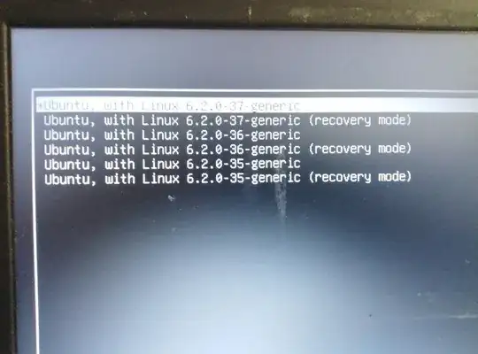

I rebooted to an earlier kernel version
If I choose the version 6.2.0-36 , the wireless is back

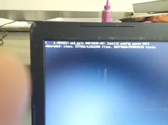

Also I have the following invalid config message when rebooting enter image description here
If I choose the version 6.2.0-35 , the wireless works and the error message is no longer there;but, the computer freeze , browser close by itself, and log off...

After typing the command: sudo dmesg | grep gpio
[ 1.488055] amd_gpio AMDI0030:00: Invalid config param 0014
1.475704] amd_gpio AMDI0030:00: Invalid config param 0014
After restarting normally the computer there is still the same invalid message appearing during booting
