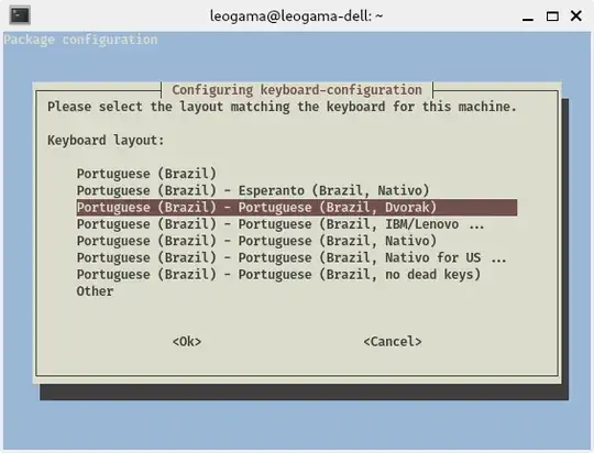

6. Apply the keyboard layout to the login screen and Linux console
When you are 100% sure that the customized layout is working, you may apply it to the login screen and the Linux console (the pseudo-terminals that are accessed by pressing Ctrl + Alt + F2 through Ctrl + Alt + F6).
Run this command and select the keyboard layout/variant you've just modified:
$ sudo dpkg-reconfigure keyboard-configuration
Finally, restart the PC and check if the customized layout was applied to the login screen as well.
