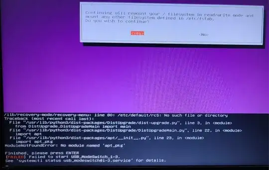

And when opening a virtual terminal (CTRL+ALT+F3) it first displays ModuleNotFoundError: No module named 'apt__pkg', and then it (the virtual terminal) keeps on working normally.

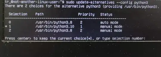

I tried leaving python3.10 as the only python-alternatives and tried adding other alternatives (python3.8), but the issue persists.

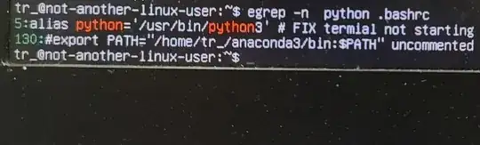

I added alias python='usr/bin/python3' to my .bashrc
I commented the export $PATH=... by anaconda

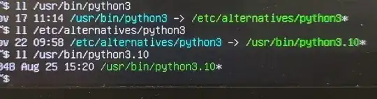

The only installed version right now is 3.10.6. python -V as well as python3 -V give 3.10.6

Recovery mode
recovery

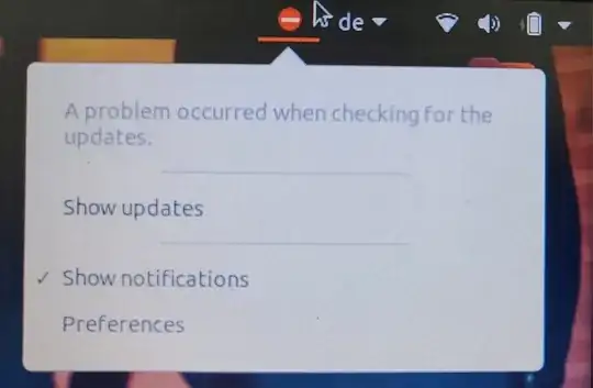

Updates
updates
.bashrc
.bashrc
python -V
python -V
update-alternatives
update-alternatives
