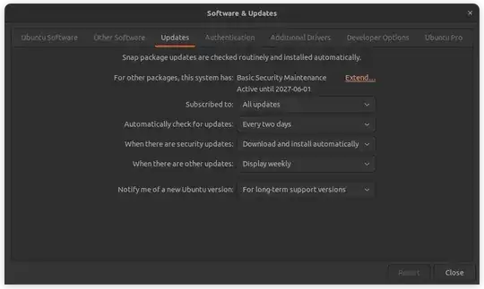

using the Software & updates tool you can set you update policies enter image description here
