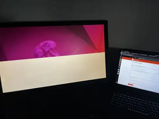

Yesterday I connected an Asus External monitor to my laptop dualbooting Ubuntu and Windows 11, it worked perfectly with windows but when I use it in Ubuntu, it shows something like this in the image:
image of my monitor
I tried a lot of stuff like changing drivers from Additional drivers, using Ubuntu on Xorg, changing resolutions from Display Setting. Here is what Xrandr outputs:

What should I be doing or What am I doing wrong?
Same issue happened to me this morning - Followed these instructions, restarted and it worked. Auto-install used driver versions 550.
