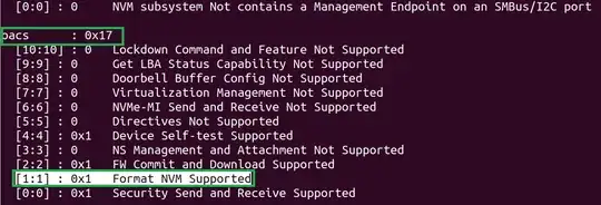

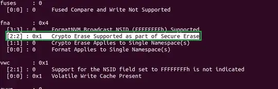

Trying to Secure Erase NVM drive but failed with CMD_SEQ_ERROR: Below is a summary of what/how I am doing to perform the Secure Erase.
