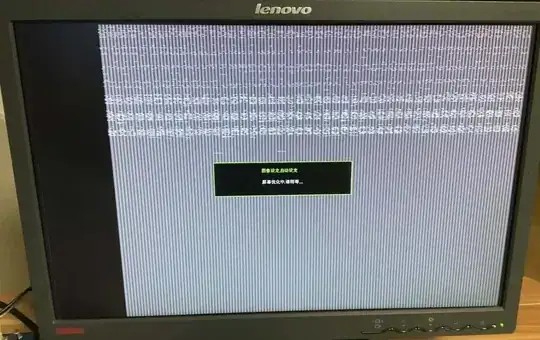

If I boot the Ubuntu installer by its default behavior, on some GUI installer phase, the screen is scrambled, shown below:
Scrambled video output

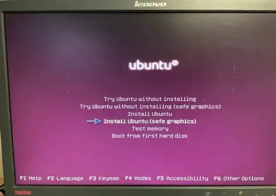

Later, I find that if I execute the "Install Ubuntu (safe graphics)" menu item, the GUI installer gives normal video output, then I can finish the install phase normally.

However, once the formal(installed) Linux boots up, the screen scrambles again, and I think it the installer did NOT relay "safe graphics" trait to the formal Ubuntu instance.
