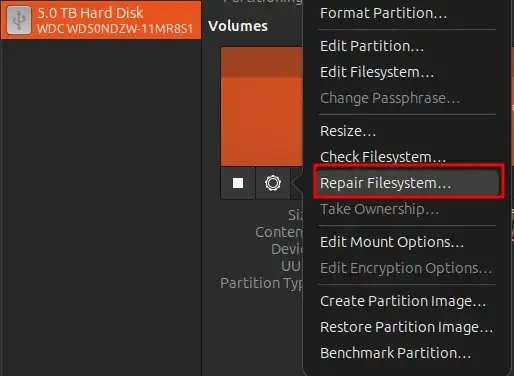

I have same problem after upgrading to 23.10 (just finished today actually).
I fixed it by using "Repair Filesystem..." option in Disks apps.
However there are warning regarding data loss so please be aware of that and do it with your own risk.
I had the same problem, after upgrading ubuntu to 23.10 all of usb disks stop working. I confirm that repairing filesystem in Disk app solve the problem.
