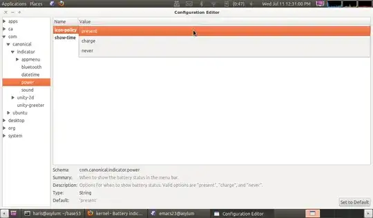

sudo apt-get install dconf-editor
dconf-editor window
