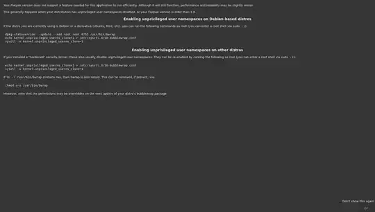

I tried to set setuid for bwrap:
$ sudo chmod 4755 /usr/bin/bwrap
That makes flatpaks run, but with an ugly warning. I don’t think that’s a correct solution.

The kernel feature allowing unprivileged users namespaces is enabled by default in recent Ubuntu kernels ... That is a requirement for Bubblewrap to work without the setuid bit (the default) or otherwise the setuid bit on the executable binary file i.e. /usr/bin/bwrap might be required.
Note #4
The default ownership and permissions on the executable /usr/bin/bwrap should be:
$ ls -l /usr/bin/bwrap
-rwxr-xr-x 1 root root 72160 Feb 25  2022 /usr/bin/bwrap
... those can be restored with first setting ownership:
sudo chown root:root /usr/bin/bwrap
... then setting permissions:
sudo chmod 0755 /usr/bin/bwrap
or both actions at once with:
sudo dpkg-statoverride --update --add root root 0755 /usr/bin/bwrap
