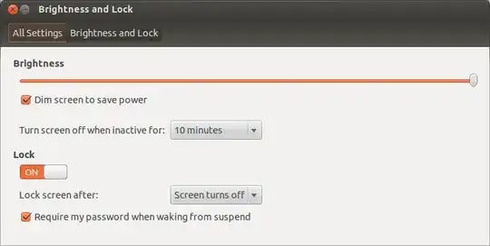

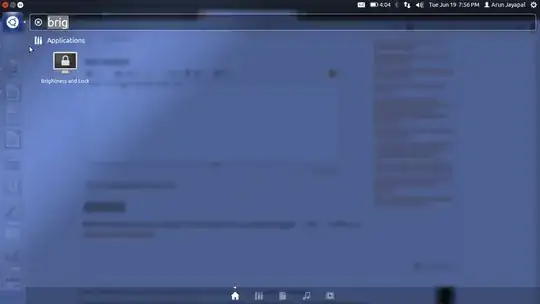

There is an app for it...Brightness And Lock
