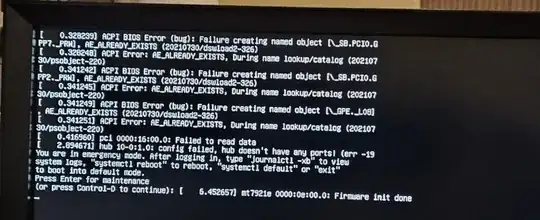

Unfortunately I got hit by a major update error yesterday. Over 200 packages were pushed for Kubuntu 22.04. It basically bricked my system GUI - but I could use GRUB and get to a console and save the data. Is there a way to turn off UBSAN until everyone is onboard with it? Also, looking for any ideas how to deal with the new ASPCI issues.
Here are the two errors:
PCI Errors #1 Notice the end warning about being in "emergency mode." The logfile(s) were enormous and no help. Maintenance mode gives you a prompt - but no help, so - it's -D which gets to error #2.
I have no idea how many of these errors went by - at least two screens full: UBSAN Errors
UBSAN: array-index-out-of-bounds in /tmp/vbox.0/memobj-r0drv-linux.c:<range of numbers>:<range of numbers>
index <the numbers range 1-10> is out-of-range for type 'page *[1]'
UBSAN: array-index-out-of-bounds in /tmp/vbox.0/SUPDrvGip.c:<range of numbers>:<range of numbers> index <the numbers range 1-10> is out-of-range for type 'SUPGIPCPU [1]'
