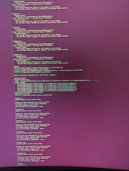

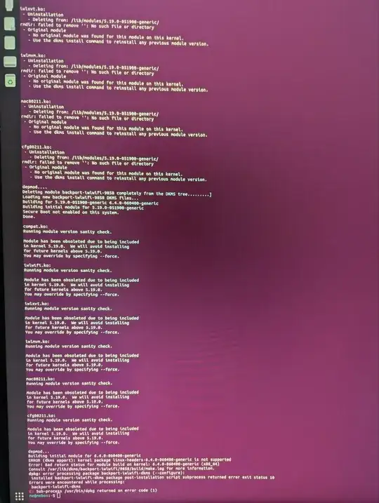

  2. I installed backport-iwlwifi-dkms which was a major hassle as I was offline and had to manually copy all dependencies over via USB but seems to have gone fine despite some error for my 6.4 kernel that I cannot completely remove for some reason after installing backport-iwlwifi-dkms (weird but doesn't matter for now). enter image description here

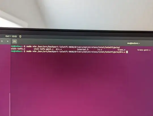

  3. I changed the file although the folder was called slightly differently, it seems to have worked: enter image description here
  4. I then installed it as indicated in the other answer, seems to have gone well: enter image description here

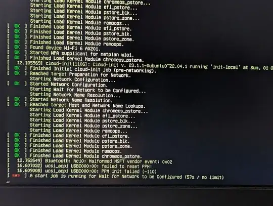

  5. Still the same issues then during reboot that I always encountered since this issue appeared: enter image description here

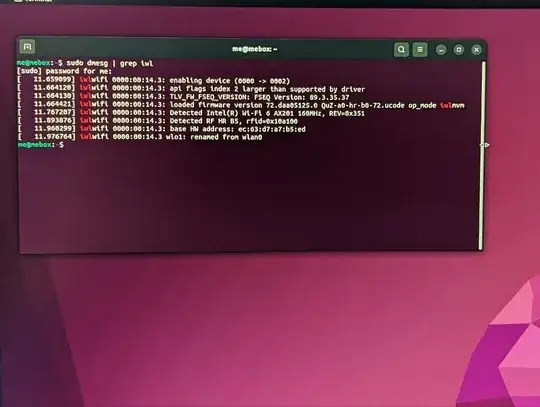

  6. Finally all done but still no wifi, here the output of sudo dmesg | grep iwl as requested in the other answer: enter image description here

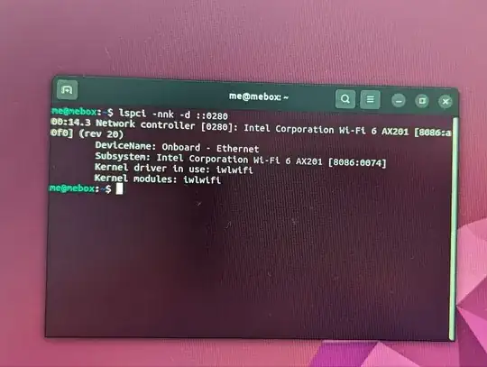

EDIT: as pointed out in the comment by A R, I do in fact run a AX201 so the instructions that I referred to in the other answer were probably not relevant. enter image description here
