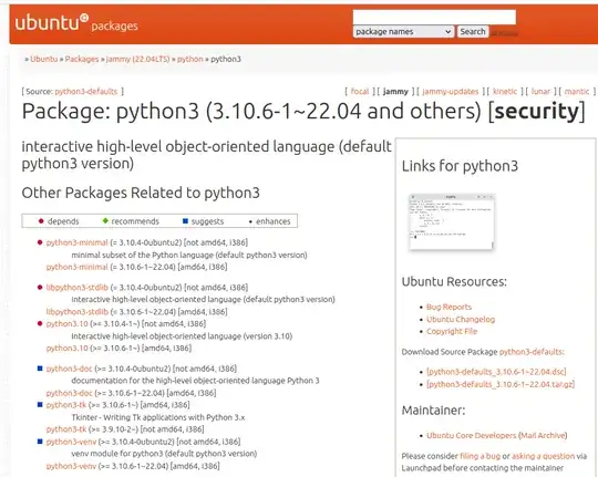

  1. Go to https://packages.ubuntu.com . Search for the python3 package. Select the package that matches your release of Ubuntu.
    Here's what it looks like for Ubuntu 22.04
  2. Look at the list of "Other Packages Related to python3"
    There are three packages listed as dependencies. Now you know the four packages you need to download from http://packages.ubuntu.com
  • python3
  • python3-minimal
  • libpython3-stdlib
  • python 3.10
    Note: Be sure to download for the correct release of Ubuntu. Don't mix versions. If you download the wrong version, the next step won't work.
  1. After downloading, you should have all four deb packages in your Downloads folder. Use dpkg to install them in this order. Use tab-completion to get package names correct.
    cd ~/Downloads
    sudo dpkg -i python3-minimal_3.10.6-1~22.04_amd64.deb
    sudo dpkg -i libpython3-stdlib_3.10.6-1~22.04_amd64.deb
    sudo dpkg -i python3.10_3.10.12-1~22.04.2_amd64.deb
    sudo dpkg -i python3_3.10.6-1~22.04_amd64.deb
That should restore Python3 on your 22.04 system, including apt functionality.
