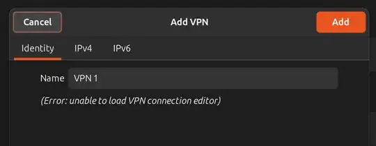

I have installed the strongswan package on Ubuntu 23.04. in order to connect to a VPN via IPsec/IKEv2. When opening the VPN settings in gnome, I receive the error message "unable to load VPN connection editor), like in the image below.
This only happens when choosing IPsec/IKEv2. On OpenVPN for example, the editor opens as expected.

For a while, the network-manager-strongswan Debian/Ubuntu package only shipped the GTK 3 version of the strongSwan NetworkManager plugin, which won't work if the application that loads it uses GTK 4.
The GTK 4 version of the plugin was only added with version 1.6.0-2 of the package in June 2023, which is shipped with Debian unstable and Ubuntu 23.10. Debian stable ships 1.6.0-1+deb12u1, which also includes the GTK 4 version of the plugin. However, Ubuntu 23.04 currently only ships 1.6.0-1, which does not.
I guess you'd have to file a bug against the Ubuntu package to notify the maintainers.
As a workaround, you should be able to configure the VPN via nm-connection-editor as that's apparently linked to GTK 3.
