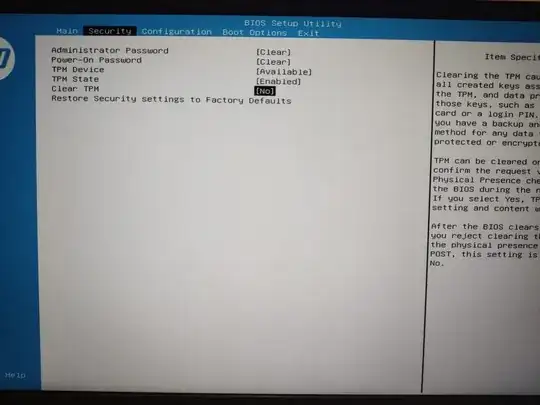

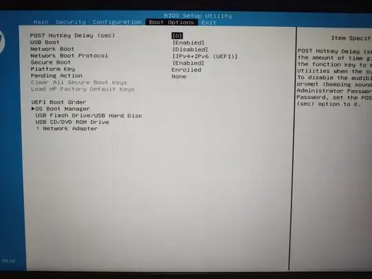

These are the photos of my BIOS settings. I cannot find where I can change the UEFI mode to Legacy/Native
BIOS settings:
Does anyone know how I can fix it?
