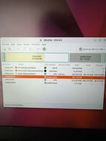

I already did the partitions as you can see in GParted.
here

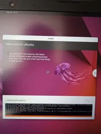

I'm stuck at detecting file systems

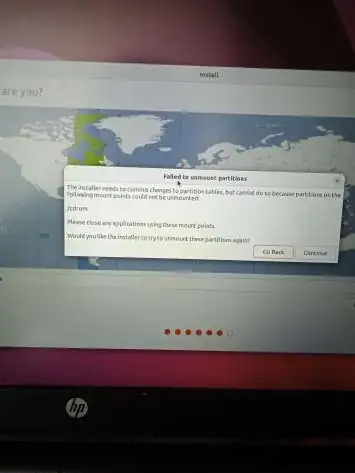

and also I got the error of:
Failed to unmount partitions
The installer needs to commit changes to partition tables, but cannot do so because partitions on the following could not be unmounted.
/cdrom
Please close any applications using these mount points.
failed to unmount partitions

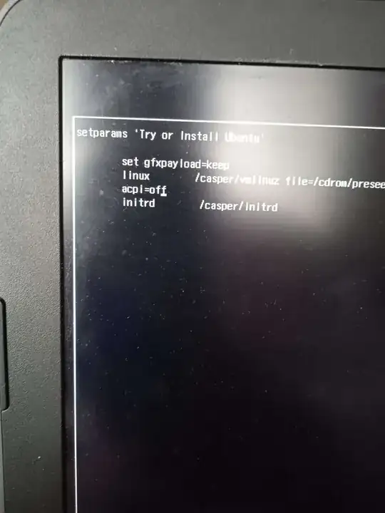

Also I already put the acpi=off as shown here.
acpi=off

I tried with an old release and i created an bootable usb with ubuntu 18.04. I installed it without any problems, seems like the problem was the ubuntu 22.04 iso but im not 100% sure.
