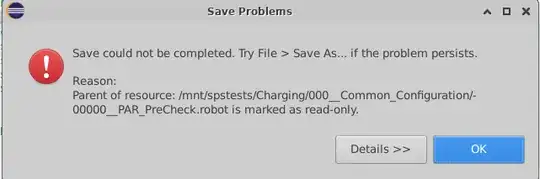

I'm using Eclipse with the RED plugin on Ubuntu with XRDP and it keeps giving me this message when I try to edit and save any file.
The folder has all the privileges.

Never used Eclipse so not sure what the problem could be but I would guess that since you are using xRDP software solution, it might be related to the polkit authorization framework. When connected remotely, you do not have all the privileges you would normally have when connected locally on the system...
You can try to follow the instructions provided in this post in askubuntu and see if this could fix your issue.
Use this at your own risk
In a nutshell, follow these instructions
#create a pkla file
sudo touch /etc/polkit-1/localauthority/50-local.d/48-udisks.pkla
#open/edit the file as sudo sudo nano /etc/polkit-1/localauthority/50-local.d/48-udisks.pkla
#Copy the code below into the file and save it
[udisks] Identity=unix-group:* Action=org.freedesktop.udisks2.* ResultAny=yes ResultInactive=yes ResultActive=yes
The file tells that any users logged remotely can perform any actions in order to manage disks.
Again, not sure this would work and not sure about the syntax...
